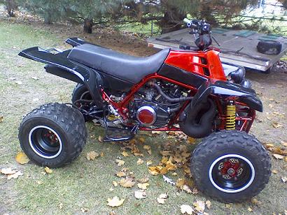

  8. 1997 banshee just rebuilt about a hour on the top end stock except for 2 into 1 graydon proline intake, 38mm carb and a twist throttle. has not seen any dirt since being torn down. * rear caliper leaks out of parking brake area when you step on the pedal, haven't had time to fix. * one rear tire needs a plug $2,300 located in utica,michigan about 25 miles north of detroit
