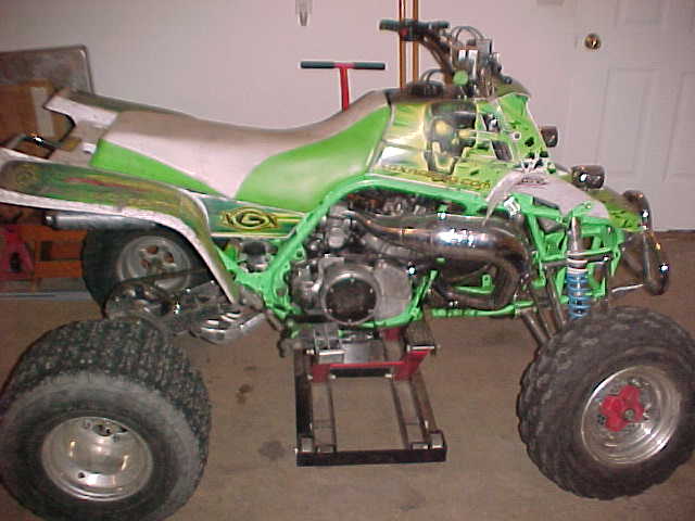

  1. 2003 with a 421 cheetah powervalve ported by trinity racing. Fresh rebuild in October by profesional. K&N filters, PWK 35, CPI inframes, 4 degree advanced timing key, lockup cluch, lonestar radiator, +2 +1 A-arms, +1 antivib steering stem, flexx bars, moose thumb throttle, chrome swingarm, work dual rate shocks, ITP rims, frame powdercoated green and many extras. My email [email protected], located Hazleton, Pa. Will help with shipping if possible. Looking to get $5,500 OBO. More pictures apon request.
