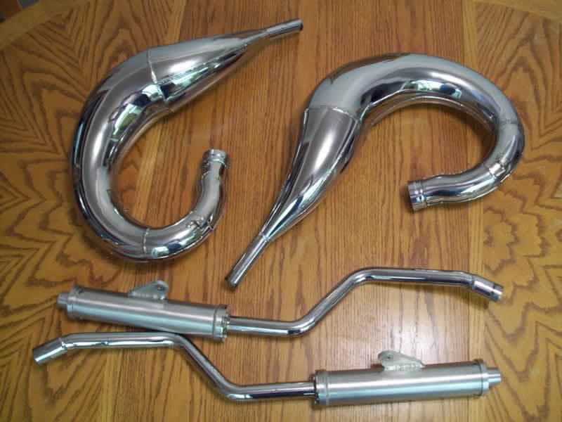

Shearer BB In Frame Show Chrome Pipes
sandrappy replied to sandrappy's topic in For Sale - Parts & Accessories
Still got the pipes and want to get them out of here. I'll do $450 shipped to your door for these pipes. This is my bottom dollar. -
bump. still got the pipes and have lots of guys interested. first one to send payment gets them. my email address above is also my paypal address. if you have any questions feel free to call! thanks -
I have a set of Shearer's in frame big bore pipes for sale. They are show chrome and in good condition, but not perfect. $465 shipped. Call or email is quickest way to reach me. 970-768-7168 [email protected]
