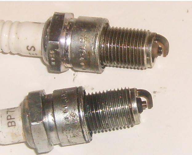

here's a pic of the plugs
Thanks in advance. EZ

Yes you need to rejet for your pipes. I would start with 260 mains and your needle in the middle clip position. That should give you a start, then do plug chops to get it dialed in exactly. That is if it has stock air filter, no porting or any mods besides the pipes.
I put new reeds in it last night. Nothing in the pipes. I did notice the one of the slides in the carbs didn't open up all the way. It was about aleast a 1/8 to 1/4 lower than the other. So I set them to be equal. Now the slides are equal. I'm going to put new plug in it today and take it out to see how it runs. I will let you all know thanks EZ
