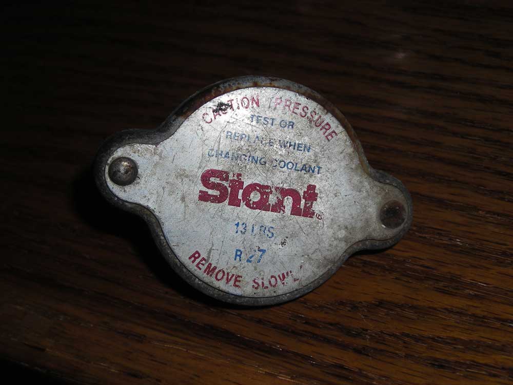

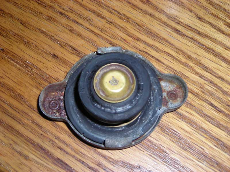

FireHead Posted July 7, 2007 Report Posted July 7, 2007 Does anybody know if there is a radiator cap for a small car that will fit our banshee radiators? I am in a bind here and need one before i leave for oklahoma on thursday and was gonna go to Orielly's or something to see if they had one that would work and i thought i would ask here to see if anyone knew by chance. As it turns out, I can answer this question. The cap that interchanges in a Stant part number R27, which is rated at 13 lbs. Quote

FireHead Posted July 7, 2007 Report Posted July 7, 2007 If you need a cap, I can overnight one to you. You can have the cap FYI: I dug up this kind of old thread so that I could enter in the Stant part number cap that I found that fits an OEM Banshee radiator during my worldly travels (Las Vegas). :geek: ...............and I am throwing away this cap. I suppose I am using the HQ for a data base for Banshee cap that I will probably forget if not archived. Quote
