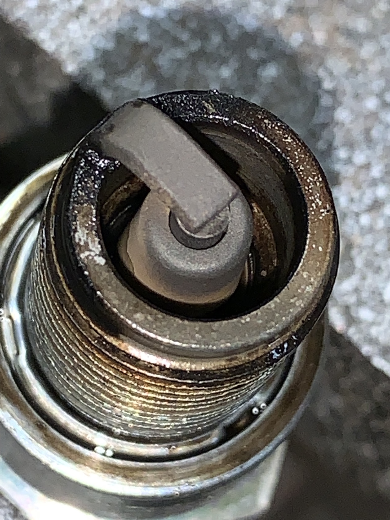

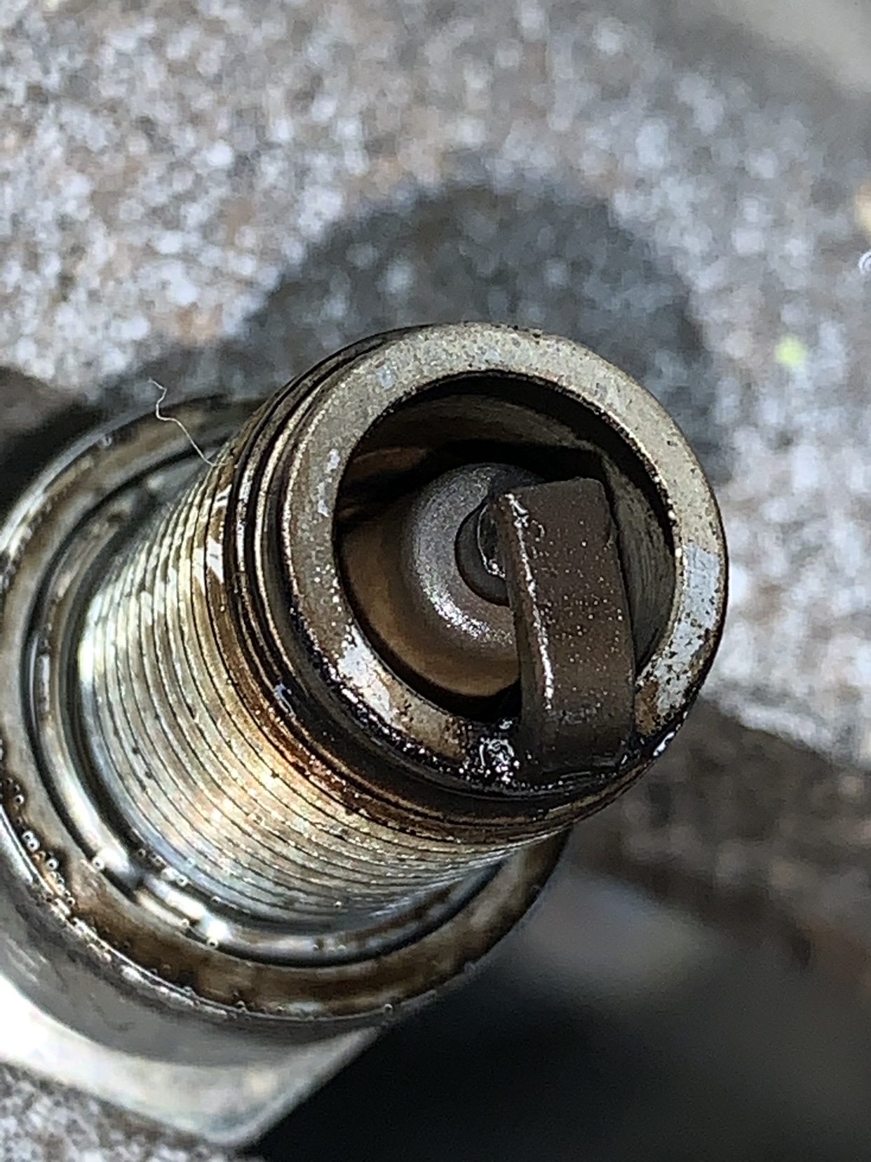

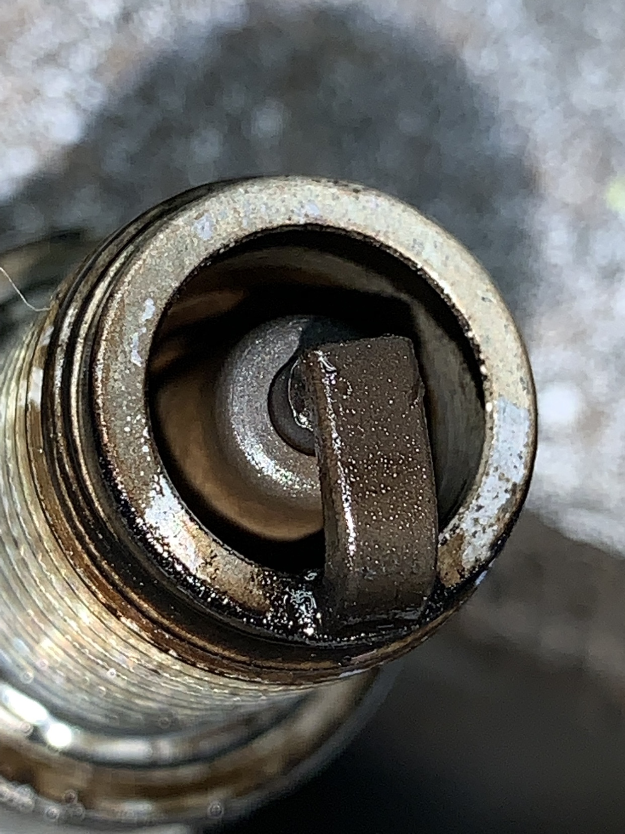

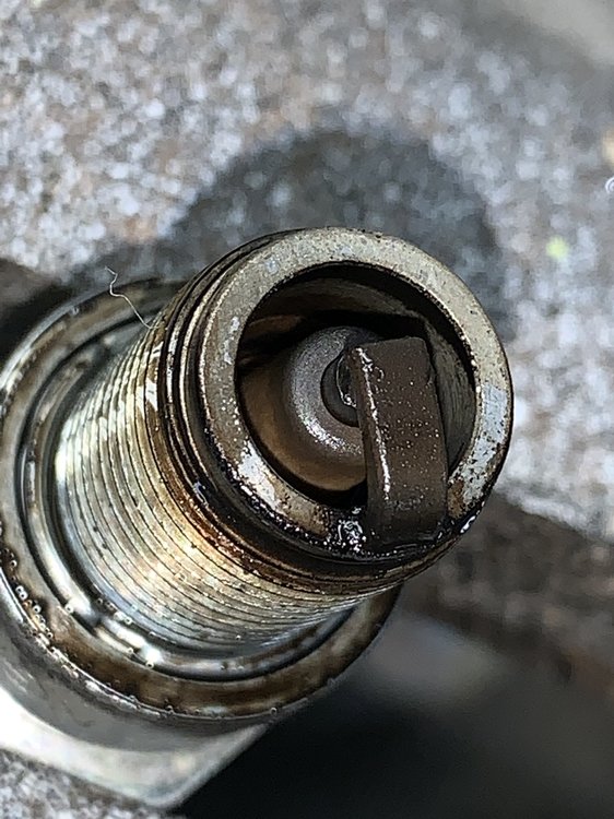

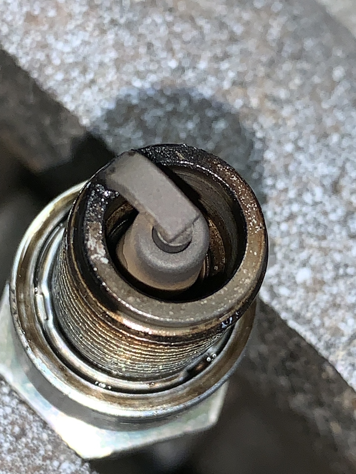

coleman66six Posted May 21, 2019 Author Report Posted May 21, 2019 Lean condition! You had an air leak, wrong gas mixture, wrong octane for your compression, or maybe too hot of a spark plug or wrong jetting. what mods do you have? High compression domes? You probably had an air leak and if you would have done a leak down test you could have caught it. SouthTexasBanshee sells a leak down tester for cheap, you’ll need it for your rebuild Well the test is done on the new top end, I can hold 6 psi for 6 mins with losing a little bit of pressure slowly. Sprayed the whole engine with soap and water and could not find air leaking from anywhere. Also decided to do a compression test and both cylinders are around 130 psi. So, do you think the air leak was in the old cylinders and top end or do you think something else caused the hole in the piston? I am running the new setup on Monday so any tips would help. Also added some plug pics for jetting reference. Thanks. Quote
gusto Posted May 21, 2019 Report Posted May 21, 2019 Ok synch your carbs now. You have two different plug readings. Check your jet sizes make sure they match and air flow your carbs. The tool is worth the $35. You can also use SouthTexasbwebsite he shows how to do it 1 Quote
coleman66six Posted May 21, 2019 Author Report Posted May 21, 2019 Ok synch your carbs now. You have two different plug readings. Check your jet sizes make sure they match and air flow your carbs. The tool is worth the $35. You can also use SouthTexasbwebsite he shows how to do itI had them synced a couple weeks ago by a shop for 80$ cause I did not have the tool. I could hear a difference before and after so I think it was done right. Chippewa Motors. So what else should I do before Monday? Thanks. Quote
