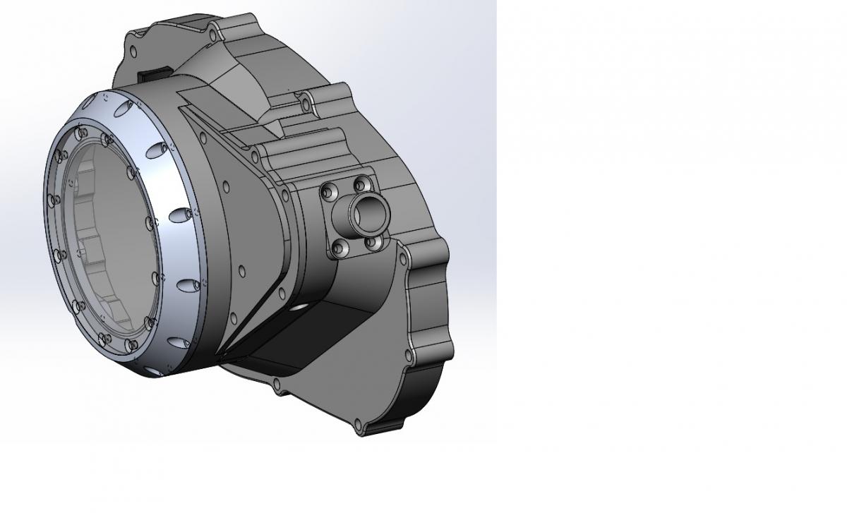

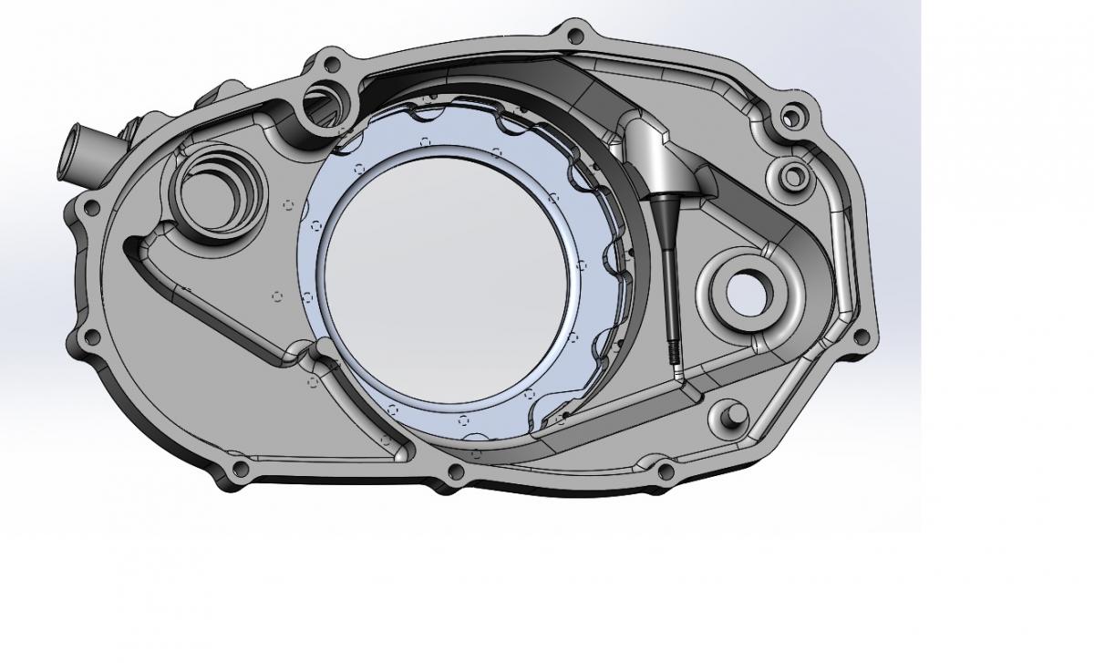

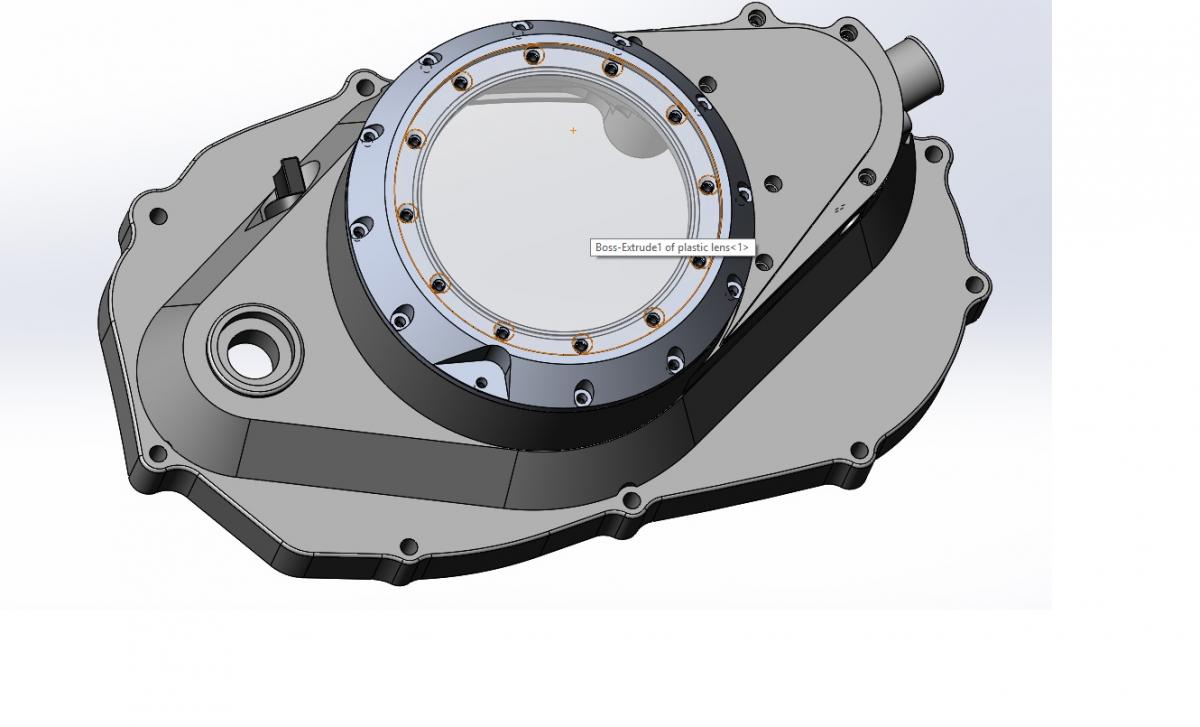

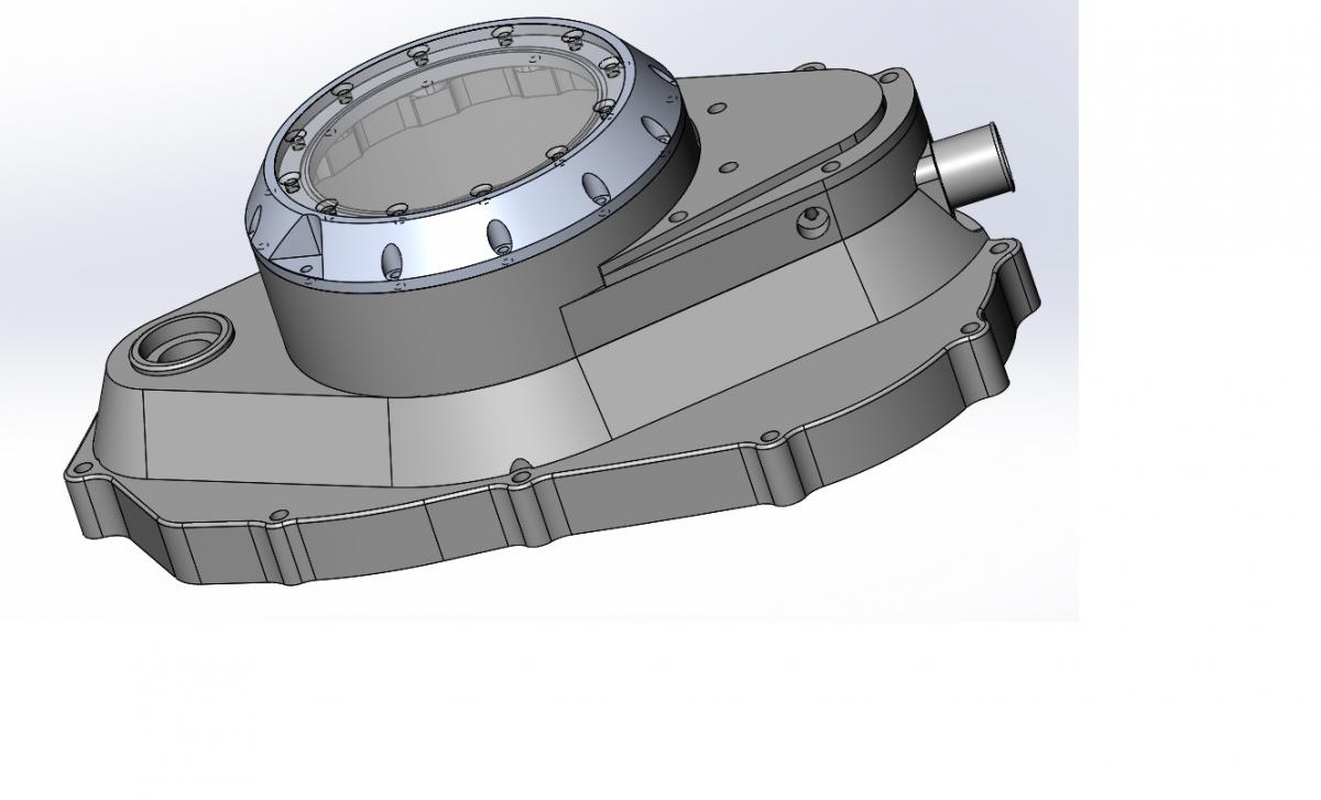

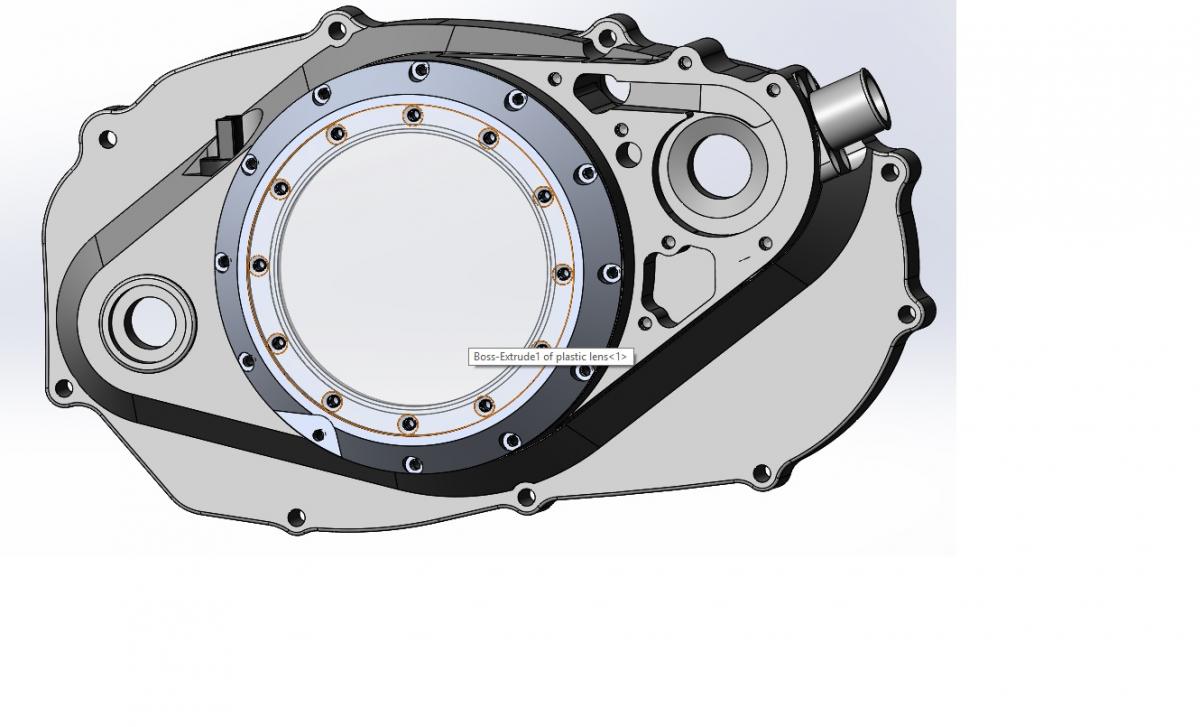

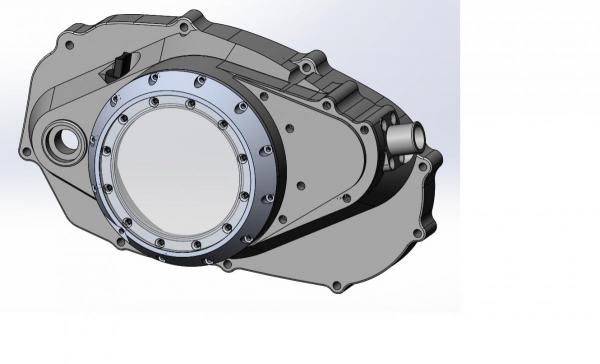

We are making chips on this billet cover starting in the morning.  It will fit an 8 plate clutch with standard lockup or up to 10 plate clutch with Driveline Performance lock up.   10 plate standard can be used with an additional spacer under lens ring.
It has improved water flow characteristics.  We simply made the flow transitions smoother.  It has a drain for the coolant built in.  It is strong at the kickstarter and overall the lightest billet cover on the market.  There is not extra material where it is not needed.  Dipstick will come with it.  You will not be able to use a stock dipstick because of the cosmetic design we made our own stick.  You can remove clutch plates by only taking off the lens ring.

We are interested input on designs to engrave on the inside of the lexan lens and designs on the water pump cover.  If you have ideas please present them.  On the lens and the water pump cover there will be design options.  The water pump cover will also be available for using our ultra impeller.

What about one machined thin as possible, without waterpump orifice or kickstarter area. Would that be possible? Basically gut out the wp area and reinforced kicker area. Do you think it could be made lighter than a modded oem cover?
